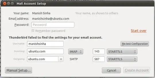

Since I do not know the password, I left it and went ahead and met a dead end
Failed to set up email ID
Anyone has been successful in adding that email ID. I have the actual email added in Thunderbird to which this email id maps to. Do I need to modify that?

You can create a dummy @ubuntu.com account in Thunderbird and configure it so that it uses your gmail SMTP settings. What you did wrong above is that you tried to set up a IMAP/POP/SMTP server for ubuntu.com, which are not available.
