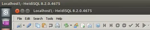

In Unity DE, when Wine app is maximized, it doesn't hide the titlebar so the window can't be fully maximized. It looks something like this:
titlebar still showing on maximize

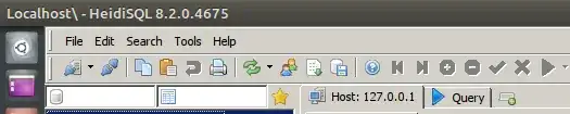

If you got that right, your wine app titlebar should no longer appear when the app is maximized and it will be shown back when you unmaximized it.
Titlebar is hidden on maximize
