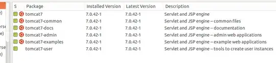

Installed Tomcat7 via repository via Synaptic package manager
& pasted my app(Beerv1) folder to /var/lib/tomcat7/webapps/ & also to /usr/share/tomcat7-root/
