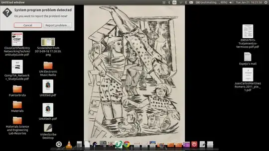

This notification appears everytime I log in: Saucy Salamander
I am using Ubuntu 13.10 Saucy Salamander 32Bit.

Fixed by improving keyboard shortcuts in the Cairo-Dock app:
  • Corrected Lock Screen Shortcut as Super+L somehow is not allowed.
  • Corrected Use Keyboard to navigate Cairo Dock as Super+Enter is somehow not allowed.
