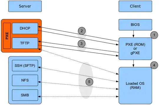

How it works?
This is my understanding!

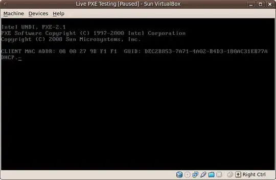

  1. Client machine is powered on. BIOS scans for devices. Then it follows by trying to load boot-loader from required device as listed in Boot Order/Sequence. It loads PXE from network card ROM.
  2. PXE (client side) broadcast a request for an IP. DHCP server reply with the required information: IP, Next Server IP (TFTP server IP), pxelinux.0 (PXE bootstrap loader file name), ...etc

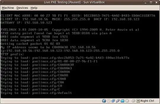

  3. PXE (client side) requests pxelinux.0 file from TFTP server, loads it to RAM then passes control to pxelinux.0.
    pxelinux.0 gets boot configuration file from TFTP server with name as:
    (if it doesn't exist it tries with the next)
    • UUID
    • MAC
    • IP in Capital Hex
    • A portion of the IP
    • Drops to default file

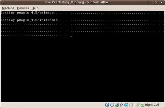

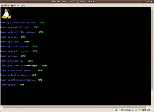

  4. Either user choice or default menu entry. pxelinux.0 requests the corresponding kernel and RAMDisk from the TFTP server and loads them to RAM.
    Then passes boot parameters and control to the loaded kernel.
  5. Kernel loads the remaining parts from TFTP server or any other protocol server depending its features/properties.

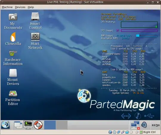

These instructions were tested on Ubuntu 9.10 & Ubuntu 10.04 on a real machine. They should be still valid with only few changes may be. (Updated & Tested for Ubuntu 14.04 on VirtualBox , check edit revisions for old releases)
My target was PartedMagic 4.5, it should be similar to Ubuntu or any Linux distribution.

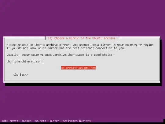

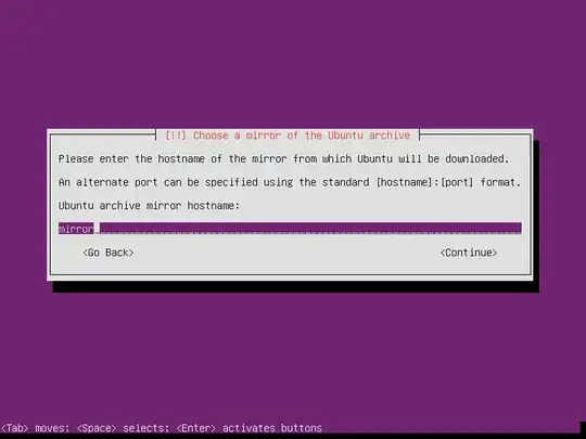

  • Ubuntu Netboot Image from cdimage.ubuntu.com/netboot/ provides installing Ubuntu from network and it will ask to download all required packages from the official mirror or a local one if you have one.
    Most users are looking for booting live image through PXE. This question was only to setup a PXE server. See Ubuntu Wiki: Installation - LocalNet
    Ubuntu NetBoot - Official archive mirror Ubuntu NetBoot - Custom/Local archive mirror

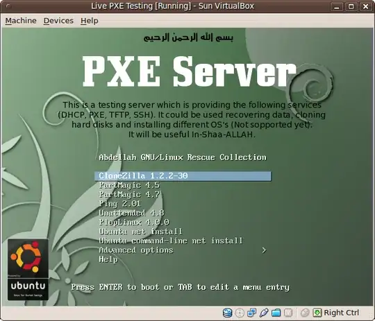

  • PXE Menu can be customized, best template to learn from is Ubuntu NetBoot. See Pxeboot Multiple image
  • memdisk can be used to load directly the ISO or floppy disk images through PXE. syslinux-common package has a copy. Client should have enough RAM to hold the image plus a portion for running the loaded OS.
