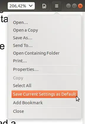

Evince (default PDF viewer) should automatically remember individual display settings for different documents. However, in 10.04, there doesn't appear to be a preference for the default view mode.
In Ubuntu 10.10+ (GNOME 2.30+), Evince has an option on the Edit menu for this: "Save current settings as default".
screenshot
In that case you would change the zoom to Best Fit and set up all of your display preferences, and then activate that option which would apply to future documents. There are other PDF viewers out there that also do this, but I haven't found any as simple to use as Evince.
