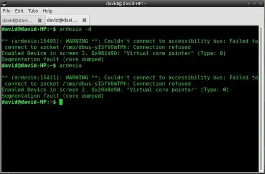

[UPDATE 3]: Upon trying the suggestion in the comments by @fossfreedom, I got the following error from ardesia:
I then tried it a few more times, and I got it to not break down once, but it still wouldn't draw. Perhaps of note: sometimes when I quit aredsia, the drawing that I tried to do flashes briefly before the program closes. Not sure what this could mean, but I think it shows that it's not totally broken...

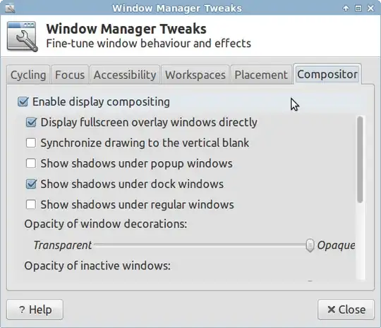

  1. Downgrade Ardesia to version 1.0-1
  2. Launch an alternative window manager (xfwm4 is a light one used in Xubuntu):
    xfwm4 --replace --sm-client-disable &
  3. Run xfwm4-tweaks-settings → Compositor → Check Enable Display Compositing
enable composite for xfwm4
Notes:
  1. Some combination may not work, it's may be worth to try:
    • Compile it from source.
    • Other compositor in combination with xfwm4: xcompmgr -c , compton -c or cairo-compmgr
  2. For permanent settings, replace openbox with xfwm4 in .config/lxsession/Lubuntu/desktop.conf:
    [Session]
    windows_manager/command=xfwm4
    Using separate compositor, add a composite manager command to .config/lxsession/Lubuntu/autostart, Example:
    compton -c --backend glx

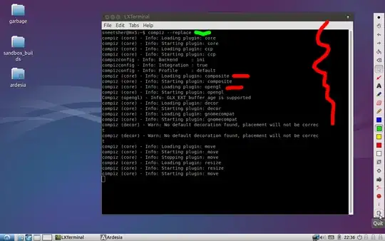

  1. Install compiz and ccsm
    sudo apt-get install compiz compizconfig-settings-manager metacity
  2. Open CCSM:
    • General category → Enable Composite , Gnome Compatibility & OpenGL
    • Effects → Enable Window Decoration
    • Window Management → Enable Move Window, Resize Window (as minimum, you can enable any option you want)
    Other way, I have exported my Compiz settings
    • Create a text file, add these to it (skipped defaults):
      [core]
      s0_active_plugins = core;composite;opengl;decor;gnomecompat;resize;move;
      [composite]
      s0_refresh_rate = 50
      Or my full settings export here.
    • CCSM → Preferences → Import
  3. Run compiz
    compiz --replace &
  4. Run Ardesia
