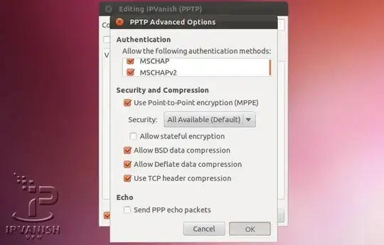

I have setup a VPN configuration file, the connection is responding but in order to actually connect to it I need to enable MSCHAP, MSCHAPv2 and MPPE, just like the picture here:
The problem arises when I need to do this from the terminal since I only have ssh access. I added this to my /etc/ppp/options.pptp:
refuse-pap
refuse-eap
refuse-chap
#refuse-mschap
require-mppe-128
When I try to dial the connection pon myvpn nodetach I get this response:
Using interface ppp0
Connect: ppp0 <--> /dev/pts/1
MPPE required, but MS-CHAP[v2] auth not performed.
Connection terminated.
Any hint how to set this from terminal?
