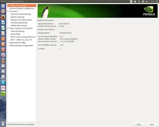

Ubuntu version 13.10 Nvidia Driver version is 319.60 and also installed prime.
In the Nvidia Settings it picks up all 3 monitors but only display on the intel screen. I have not made any changes to xorg.conf as I am not sure what to insert.
Is this where my problem is or am I missing something else?
Here is a screenshot of my nvidia settings: screenshot of my nvidia settings

You seam to have two option:
there is the nvidia proprietary solution
http://www.webupd8.org/2013/08/using-nvidia-graphics-drivers-with.html
and there is the open driver solution with the bumblebee solution
How to switch between hybrid Graphics Intel/nVidia?
I am afraid that both require the GPU to be used all the time...
