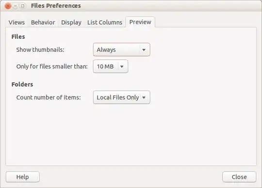

Nautilus (my version 3.8.2) saves it's thumbnails in ~/.thumbnails and ~/.cache/thumbnails. By default it shows thumbnails only for local files, but you could change it in preferences. enter image description here
And if the mount point for you remote server is the same, nautilus saves those thumbnails.

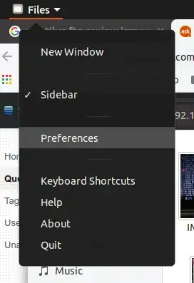

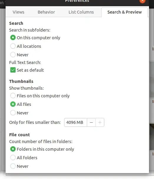

Start from Ubuntu 18.10, you should try this:
  1. FilesPreferences
  2. Search & Preview, then under Thumbnails, select All files.
