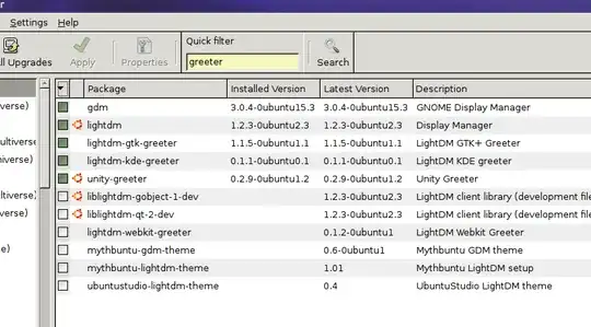

  2. This presents me the desktop interface without Unity, so I opened a terminal and used the command unity.
  3. Re-installing the removed packages, but to no avail.
package manager
OK. So now I have the desktop environment, but I just want to get into my desktop environment the regular way.

UPDATE:
GDM works, opened terminal and entered command sudo dpkg-reconfigure gdm and rebooted. Xorg started as well as Unity, But I want the Unity GUI. Until I find a way to do that I will stick with this.
Nkciy84
  • 997
  1. Open terminal
  2. enter sudo dpkg-reconfigure gdm followed by password when prompted
  3. enter sudo reboot and enter password when prompted Everything works. No Unity-greeter though
