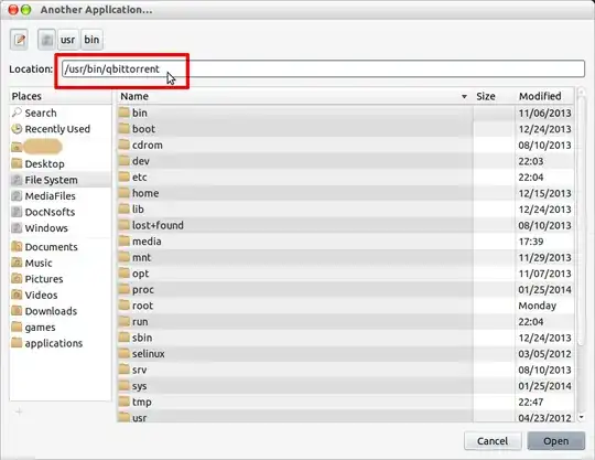

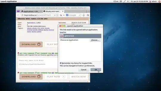

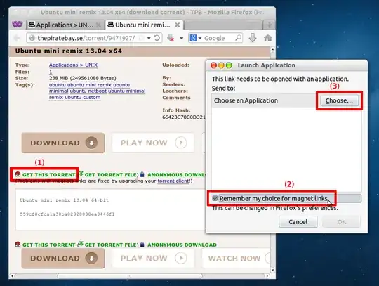

I am trying to download a file using the bittorrent protocol but I can't get my browser to open the magnet link in my torrent client. I have qbittorrent installed but I still can't seem to download from magnet links.
A little box always shows up asking what application I want to use and there is a button that says "browse" but I can't choose anything.
How can I use such links on Ubuntu?

  1. Click the torrent link to open which should start the Launch Application window where you should check mark the Remember my choice for magnetic links, and click the Choose... button; snap1

  3. Then in the path input box labelled Location: type the path of the executable of the application - /usr/bin/qbittorrent and click Open; snap3
  4. Having the desired launch application selected, now click the OK button. This will start the application qBittorrent and you can continue managing your download from there. snap4
