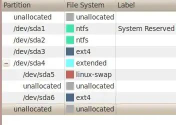

Below pictures (captured form gparted) show my problems!
Partitioning Table
sda1 -> Windows system reserved (created automatically by windows os) -> PRIMARY
sda2 -> Win 8.1 -> PRIMARY
sda3 -> Ubuntu -> PRIMARY
sda5 -> swap as a logical partition, marked as 'Beginning'
sda6 -> home partition as a logical partition, marked as 'end'

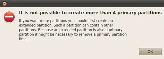

Now, there is a little free space that I want to install a new linux distro on it, but When I try to create a new extended-logical partition I get this error: Cannot create a new partition. There are already four primary partitions.
Add a new partition: Error
Why ubuntu created sda4 while I had choosed 'logical' for both swap & home partitions.
How can I get rid of sda4 and make a new partition?

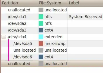

It was false,you try to create a new partition on the second unallocated space which was outside the extended partition.You had already four primary partitions,so that the error appears.See the below screenshot,
But you can be able to create a new logical partition on the first unallocated space which was inside the extended partition.
Logical partitions are always comes inside the extended partition.You choose swap and home partitions as logical,so it comes under extended partition /dev/sda4.
You can't be able to delete sda4 because your home and swap partitions are inside on that sda4 extended partition.
