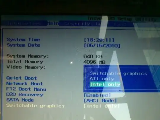

You can disable it in your bios under Graphic settings, I can't tell you exactly where the option is on you're laptop because every BIOS is different, but it will look something like this: enter image description here
