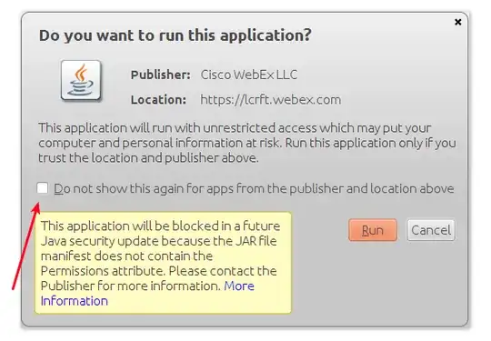

I hurriedly clicked past a Java dialog box similar to this one and checked the "Do not show this again..." box.
Note that this is not the exact dialog box, it was the most similar one I could find. I don't remember the yellow box with "This application will be blocked..."

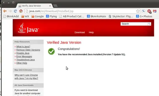

Java verified on the machine by Java webpage:

I encountered the same problem and discovered the solution.
The problem is that the Webex Java applet is incompatible with Java 7 update 51. The java update tightened the security controls on Java web applets and the version of the Webex java applet that both you and I are using isn't yet updated to meet those tightened security controls.
Until the version of the Webex java applet that we are using gets updated, there is a work-around. You can open the "Oracle Java 7 Web Start" control panel that should have gotten installed in Ubuntu with Java 7 and change one or both of the following settings in the "Security" tab: a) Change the Security Setting from High to Medium OR b) Add the https address of your webex server to the "Exception Site List". For example if the URL to your WebEx server is https://foobar.webex.com then put "https://foobar.webex.com" in the "Exception Site List".
Once you do one of those two things Webex should work for you again. It works for me now.
You should add the desired site exuting java in your Exception List.
for ubuntu with official ORACLE java 8:
sudo /usr/lib/jvm/java-8-oracle/jre/bin/ControlPanel
Then security tab to add your website.
Take a look on official oracle website:
https://www.java.com/en/download/exception_sitelist.jsp
