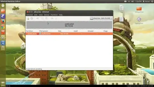

My Ubuntu OS does not recognise any external drives or devices. This started after I installed Windows XP. When I run GParted, it shows "unallocated 465.76 GiB". I ran "sudo fdisk -l -u /dev/sda" and this is what I got-

This is a screenshot of gparted:- GParted Screenshot
You can check GParted -> Information for more details (source). It is likely your partition table is violating some of the rules of ms-dos partition tables.
