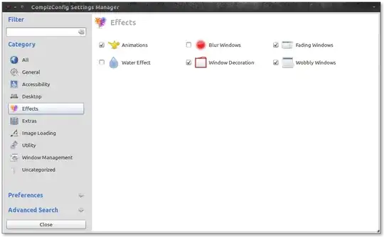

Open CompizConfig Settings Manager and on the effects tab make sure you have the 'Window Decoration' tickbox checked like below;
