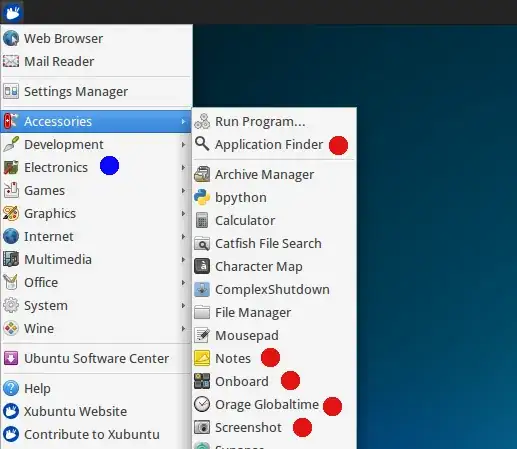

The apps that have red dots next to them, I want to uninstall, since I have synapse, kazam, xpad instead and the rest, I don't need. I tried Software Center, and synaptic and apt-get, and could not locate them.
Also how to remove xfce4-terminal? I tried apt-get, but it will remove a billion library related to xfce, is it safe to remove it that way? Because I have terminator and xterm.
I want to remove the Electronic section, because it only has Arduino IDE, which is also available in the development section, thus I don't need it.

Here's a script to find the package names:
programs_to_rm=('Application Finder' 'Notes' 'Onboard' 'Orage Globaltime' 'Screenshot')
results=()
for prog in "${programs_to_rm[@]}"; do
    result="$(grep -lR -m1 "^Name=$prog$" /usr/share/applications | tail -n1)"
    result="$(dpkg -S "$result" | head -n1)"
    results+=("${result%%: *}")
done
echo "${results[@]}"
Basically, this should work:
sudo apt-get remove xfce4-appfinder xfce4-notes onboard orage xfce4-screenshooter
To remove the Electronics section:
  1. Command:
    sudo -H nano "$(grep -lRm1 'Arduino IDE' /usr/share/applications)"
  2. Press Ctrl+W, then type Categories=Enter. Edit the line to remove Electronics;.

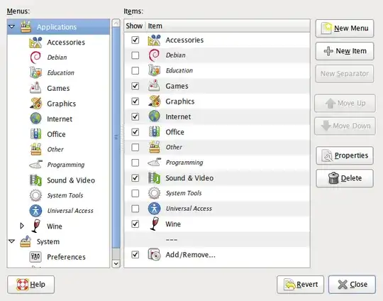

To remove them from the Menu, Alacarte, or 'Main Menu' should work.
alacarte
