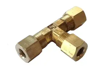

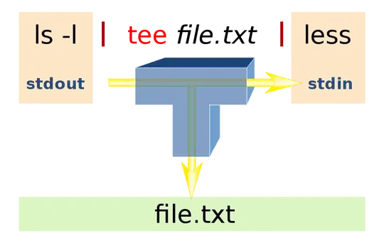

tee takes the standard input stream and writes it to both the standard output stream as well as a file stream. If it helps people remember, the command name comes from a T-splitter in plumbing. There is a nice Wikipedia article where I learned about the origin of the command name.
