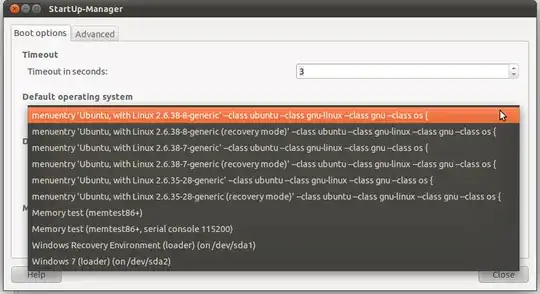

An nice application is available in the Software Centre which should help you. Its called "Startup Manager".
It looks like this: enter image description here
Choose the Kernel you wish to default to in the drop-down list and then click Close to complete.
