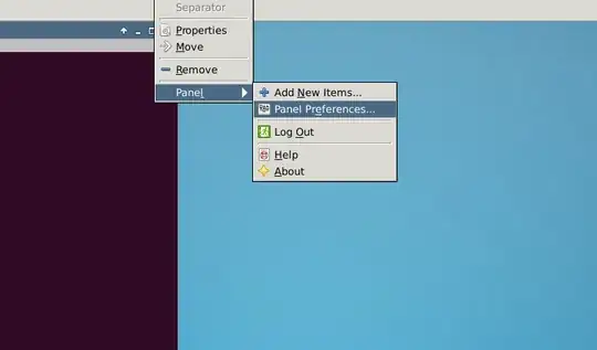

This can be changed, but the toggle is really well hidden.
Right click on the panel, select "Panel" then "Panel Preferences".

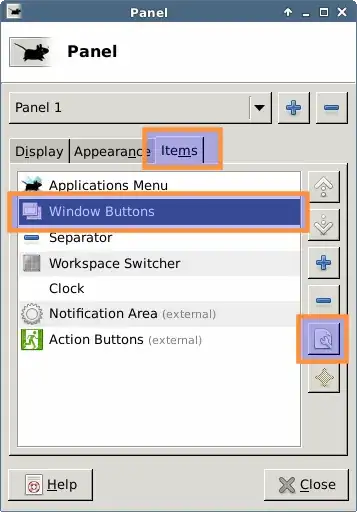

Switch to the "Items" tab, select the "Window Buttons" item in the list and click the wrench icon.

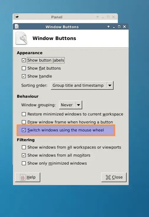

Then uncheck "Switch windows using the mouse wheel"
You're done!
