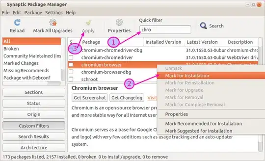

  • Open synaptic package manager from Dash.
  • Search for the package you have to install.
  • After finding it,right click on it and select Mark for installation.And select Apply.
  • Package will be installed successfully.

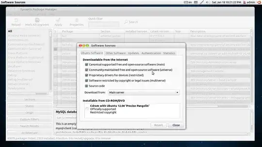

Since you've just installed it, from the menu select Settings -> Repositories and under Ubuntu Software select the repositories like main, universe, restricted and others and close the window.
snap0a
Then click Reload to reload the package list; after the reload is complete you can search for the packages and install them.

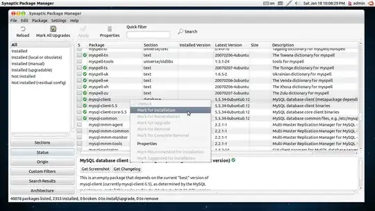

To install a package:
In the synaptic package manager right click the package you want to install and select Mark for Installation then click Apply.
snap1
