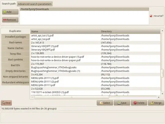

FSlint
fslint is a graphical program that can find duplicate files of any type by md5sum. If the images are not identical, they won't be flagged as duplicates. The image below shows a bunch of duplicate pdf files in my Downloads directory:

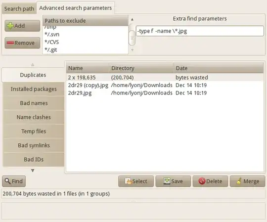

You can change the advanced search parameters to search by file type and restrict yourself to images only. That's done through changing the "extra find parameters" as find command options. For example, here I am only looking for *.jpg files (in the same path, only looking at my "Downloads" folder:
