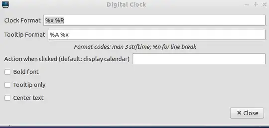

If you want the date to be shown on the panel in Lubuntu:
  1. Right click on the clock in the panel and select "Digital Clock" Settings.
  2. Edit Clock Format so it reads %x %R .
  3. Close that window.
If you want some other date formatting just look up the available options in man strftime.
