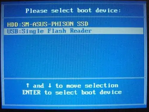

With the USB one, when the computer starts, look for Boot Device selection. Select the one referencing to your USB. It may look something like: enter image description here
If that does not work, try BIOS Boot settings, and placing USB booting as the top of the list of Boot Order.
