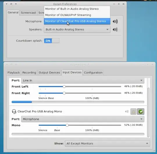

I am trying to record a short screencast using Kazam. Unfortunately, it refuses to record sound from my Logitech USB headset. The Kazam preferences show only "Monitor*" devices. What can I do to make it see the other recording devices?
A trick of PulseAudio could be used as workaround, by creating a Virtual Sink and Loopback microphone to it.
pactl load-module module-null-sink sink_name=Virtual1
pactl load-module module-loopback latency_msec=1 sink=Virtual1
I just give it a try, after I verified the source code of those combo boxes. It does record microphone. The only problem here is "Microphone" and "Speakers" label should be swapped. You may count it as a bug!
Here is, it is already reported & fix released. lp bug#1184010
So:
Speakers to record microphoneMicrophone to record speakers
