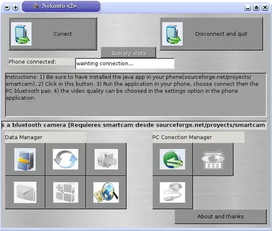

To get a window like this: enter image description here
With most functionalities disabled at least in initial encounters, and with nokia x3 mobile hard-set connected with usb. Not so interesting and useful it seemed to me.
