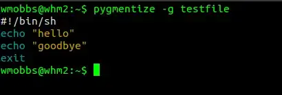

As from this answer here, you can use the python-pygments packages to highlight stuff. First do:
sudo apt-get install python-pygments python3-pygments
then:
pygmentize -g FILENAME
then have a go:

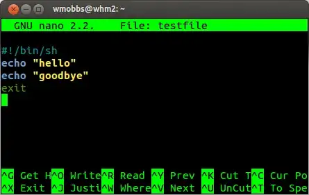

Another thing would be to just use nano:
nano testfile

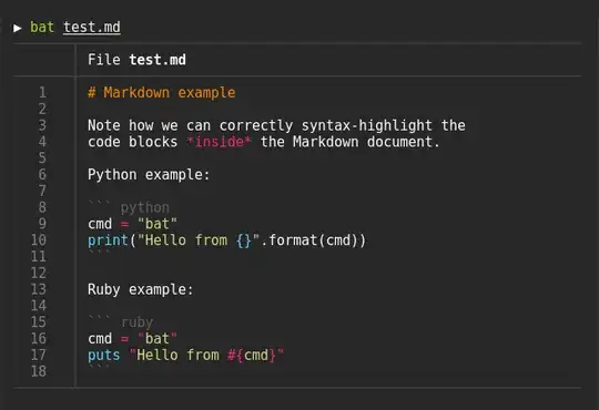

Bat — A cat clone with wings
You might also want to check out bat which has the following features:
  • Syntax highlighting
  • Git integration
  • Optionally showing non-printable characters
  • Automatic paging with less
  • File concatenation as a drop-in replacement for cat when redirected
 Preview
Screenshot of bat showing a colored file
Picture taken from the official GitHub

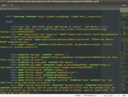

Rather than installing a third party package, you can simply use gedit to quickly view a file with syntax highlighting. For example copy the address bar above and paste into your terminal:
gedit https://askubuntu.com/questions/405960/can-cat-show-files-using-code-markup-in-colors
You will see this question in HTML with formatted colors:
  • You can use familiar gedit navigation keys
  • You can turn line wrap on/off
  • You can use plugins like I have installed for 80 character gutter and document overview (far right) with thumbnail slider
  • The only caveat is you need to remember Alt+F4 to quickly close the window to simulate cat which doesn't require keystrokes to close.
