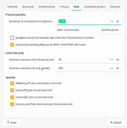

To open the port, you need to work at two levels, computer and modem router:
  1. Open Transmission and go in Edit -> Preferences -> Network
  2. Copy the port number (eg. 51414)
  3. Check "Use UPnP or NAT-PMP port forwarding from my router" enter image description here
  4. Open a terminal and, as root, give the following command to open the port in the firewall permanently:
    $ sudo firewall-cmd --permanent --add-port=51414/tcp
  5. Now the last step, that is the manual configuration of your modem router, by opening a web browser at your IP address (check the previous guide to find out it: it could be 192.168.1.100, or 192.168.1.1, or 192.168.178.1, or something else)
  6. For FRITZ!Box 7490 modem router, for example, you need to go in Internet -> Permit Access => select a device => now click on New Sharing or, if you have olready one, click on the edit icon to add a new forwarding => New permit access -> as application choose other application to enter a custom name -> as protocol choose TCP -> then as port 51414 in all the three fields => OK => OK => Apply
  7. Now test Transmission, going in Edit -> Preferences -> Network -> Check port => OPEN!
