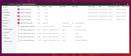

There is now an extension called nautilus-columns, which adds EXIF data as well as MP3 (ID3), PDF and more metadata. These new columns can be also used as sorting source.
Install with:
    sudo add-apt-repository ppa:atareao/nautilus-extensions
    sudo apt update
    sudo apt install nautilus-columns
