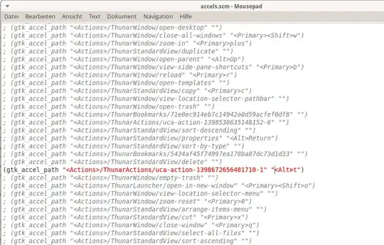

Open the file /home/username/.config/Thunar/accels.scm
than you have to search for:
;  (gtk_accel_path "<Actions>/ThunarActions/uca-action-1398672656481710-1" "")
uca stands for an custom action and the 1 at the end stands for the first action.
Change this line as follows ( Alt+t is only an example you can chose what you want ):
  (gtk_accel_path "<Actions>/ThunarActions/uca-action-1398672656481710-1" "<Alt>t")
be sure you have removed the ";" at the beginning, to uncomment the line!

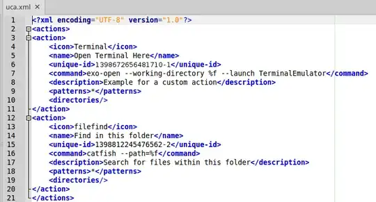

Edit 1: The pagination of the custom action are not always in a logical order. To find the right ID (unique-id) you can look into the /home/username/.config/Thunar/uca.xml file:
