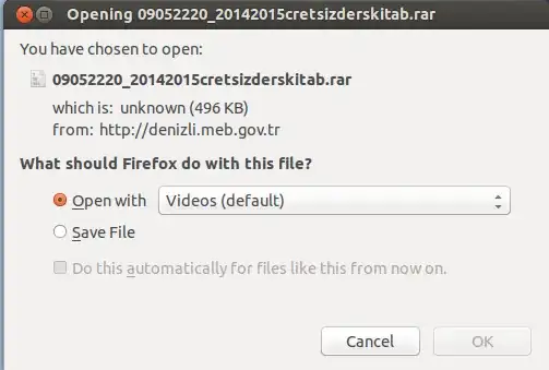

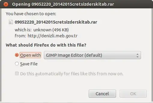

This is not a problem with firefox, it is a problem with the site you are downloading from. Your screenshot says: "which is: unknown", that means the webserver didn't send the correct mime type of the file, so firefox doesn't know what kind of file is this, so he just pops up a "random" application for it. (For me for unknown types always GIMP is suggested by firefox, for you it is Videos.)
Firefox doesn't decide the filetype based on the file's extension, it decides based on the mime type received from the server.
The server response from the site you are trying to download contains this:
Content-Type: application/octet-stream
So you see this:
ill behaving server's download dialog

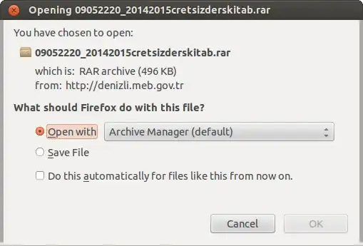

and the download window would look like this:
well behaving server's download dialog
It says: which is: RAR archive.

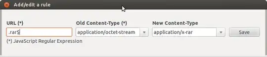

I did found a firefox extension to solve this (although I don't know how proper it is to use it, as this is a problem with the server, so it should be solved there): Force Content-Type Addon. Install it and add a new rule:
  • URL: .rar$
  • Old Content-Type: application/octet-stream
  • New Content-Type: application/x-rar
add new rule image
After this every URL which ends in .rar and has a content-type of application/octet-stream will be changed to a content-type of application/x-rar, and you will get this:
after the change content-type
