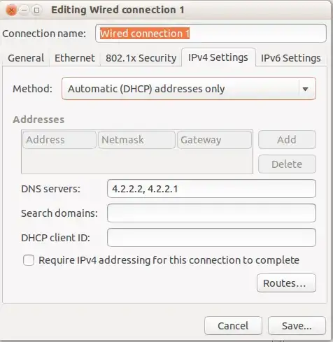

Second, solution if you can't do the first solution is to manually edit the connection rather than /etc/resolv.conf. Doing it this way should survive a reboot.
On the top panel, click on the network applet and go to Edit Connections. Choose the connection that you're having issues with and click Edit. On the IPv4 Settings tab, choose Automatic (DHCP) addresses only and fill in the DNS servers you want to use.
This will restart the connection, only pulling an IP address, while still using the DNS servers you just specified.
