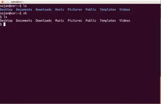

I believe this is because your user octavian and the elevation of that user's permissions happens in two different shells.
Ubuntu by default uses bash as he shell for users. When you run commands through sudo, the shell changes to sh.
Here is a screenshot demonstrating the different shells.
You can see the first time I run ls, I'm in the bash shell. You can tell because the prompt notes my username, hostname, and current directory.
When I switch to sh, the prompt changes as it's a completely different shell with different features.
There are tons of different shells available, all with different features, prompts, and customization options. One of the most customizable shell is zsh.
