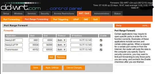

Forward/open a port on your router admin page. e.g. (192.168.0.1) to port 22 on your Ubuntu box. This will vary on the model of router that you have. It will look something like this:
You could give your friend the username, password, and router IP address (http://www.whatismyip.com/).

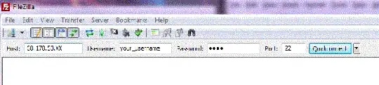

Your friend can then download filezilla and navigate your computer for any files by typing in the IP address of your router.

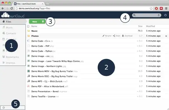

You can install OwnCloud on one of the machines and/or clients or using browser to access the files.
