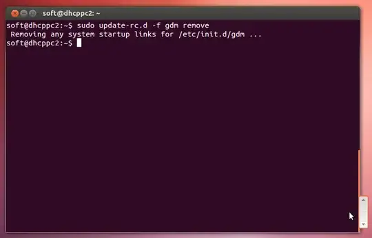

Try to disable GUI, just press Ctrl+Alt+T on your keyboard to open Terminal. When it opens, run the command(s) below:
sudo update-rc.d -f gdm remove
When you restart your computer, you’ll get text-mode login. To run GUI again:
startx
To enable GUI again:
sudo update-rc.d -f gdm defaults
Source:HTG
