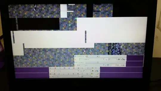

After I reinstalled Ubuntu due to I've messed up the system previously on some trial and error, I got a weird pixelated screen after my login but before the desktop appear. Other than that is no problem, i can do all my thing such as watching movie, playing steam games, etc. I really hope to fix this annoying problem so i can convince my friend to try switch to Linux.

  3. attachment 003-01, after i've type in my password and log in, the pixelated screen problem appear every time if i shutdown my laptop on the previous session.the pixelated screen01
  4. attachment 003-02, this pixelated screen problem appear if i restart my laptop on the previous session.the pixelated screen02

I suspected it was something to do with nvidia and xorg server, so I do some searching and tried something described in installing-nvidia-drivers-on-ubuntu-12-04 and on ubuntu-forums, and the problem is solved now.
The basic theory is to remove nvidia and xorg completely then reinstall them:
  1. Reboot my laptop to recovery mode by keep the Shift key pressing down after the laptop manufacturer logo appear and release it after Grub menu fully loaded, then choose the 'Recovery Mode'.
  2. Choose 'Boot Normally' when a menu appear.
  3. Open up terminal by hitting Ctrl+Alt+T.
  4. Remove the xorg.conf by typing:
    sudo rm /etc/X11/xorg.conf
  5. Remove all nvidia package by typing:
    sudo apt-get remove --purge nvidia*
  6. Remove xorg by typing:
    sudo apt-get remove --purge xserver-xorg
  7. Reinstall xorg by typing:
    sudo apt-get install xserver-xorg
  8. Reboot the system by typing:
    sudo reboot
  9. After successful reboot, the pixelated screen is gone~ (yay~!!)
  10. I open 'Additional Drivers', I see 2 nvidia drivers, version 319 and 331 (version of both is in extra information provided below them) which is not activated, so I activated version 319 and then reboot. (because I had a problem with 331 previously)
  11. Then I run a program which need 3D support, in this case a Steam game, but Steam detected there is a newer version of nvidia and ask me to update it, so I close Steam, go back to the 'Additional Drivers', choose the 331 version and activate it, then restart my laptop, and the pixelated screen is still gone~~ (double yay~!!)
