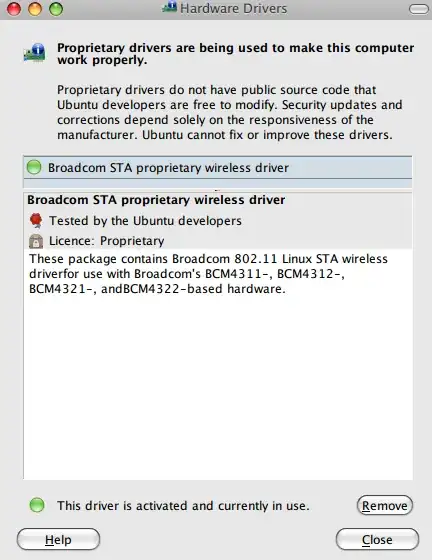

Please search for hardware-drivers or Drivers in menu open that up and keep your cabled network connected, you will see your wireless card disabled there than enable it and everything will work just fine.
  1. Click on Ubuntu Icon
  2. Search for Drivers or hardware-drivers
  3. Open that up and enbale your wireless driver from there
It will look like this
