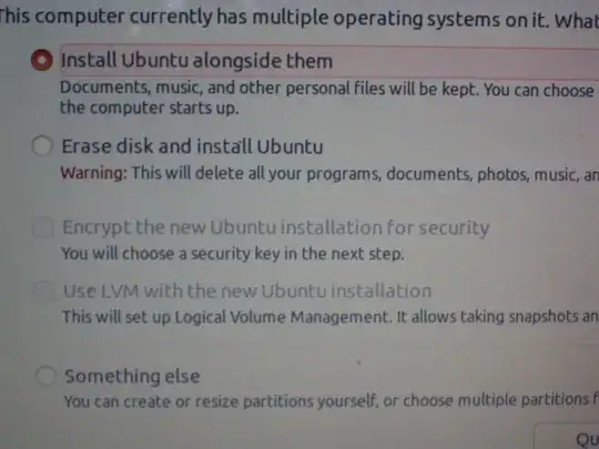

When my laptop boots from the usb, the below options are displayed as shown in the photo. (Its not having the option for erasing the current O.S. Rather it has option for erasing the whole disk!!!) photo
I will select the option of ' something else' & proceed. Then I will delete /dev/sda5 (/boot) & /dev/sda6 (/) & swap partition & create the same partitions (/boot , / & swap) by allocating sizes. ( I think there is no compulsion to create home partition & so I wont create ).Then I will proceed to install 13.10 on these newly created partitions. After the installation completes, I will login to the 13.10 O.S. Then I will delete all files & folders under /home directory. Then I will edit /etc/fstab to mount the previous home partition /dev/sda8 (this I currently have on 13.04) on /home directory. Is that a right way please?
Also, may I create btrfs file systems this time rather than ext4 for the /boot & / partitions? This fs is new & I should try it out to see how it's better.

First of all, do backups. They are never extras. Then check twice and thrice what you are doing. Verify that the partitions you are removing are the ones you want to remove, by the way, is not necessary that you remove the partitions, just format them.
If you want, you can reuse the old /home just unticking the format option in the Something Else dialog. That will save you a step. Don't use btrfs for /boot, but ext4. BTRFS is still experimental and may have problems if you use it for GRUB.

"(Its not having the option for erasing the current O.S. Rather it has option for erasing the whole disk!!!)"
This answer is only a tangential recommendation. Never trust automatic partitioning options in Ubuntu installers, as you may end up with nasty surprises. When installing Ubuntu I always prepare the partitions manually (as you seem to be planning to to do).
See Should I choose to Install alongside windows 8 or something else for an example on how manual partitioning can be approached.

I am assuming you want to preserve your personal files in the /home directory. This will only be possible if you do a system upgrade with the Ubuntu upgrade software or if you have a separate disk partition for /home and you manually parition your disk when you install Ubuntu.
When you select "Something else" at installation, simply set the /, SWAP, and /home paritions to their proper mount points (you can check these with the gnome-disk-utility included with Ubuntu, so take note as to which is sda1, sda2, etc.). Choose only the / partition to be formated. This will preserve your /home partition with your personal data, but will erase all Ubuntu system files and most applications you installed on top of Ubuntu 13.04.
