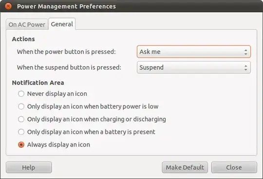

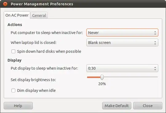

I see these two screens in Natty's Power Management, neither appear relevant:
Power Management Preferences - On AC Power Power Management Preferences - General

What is your problem you wish to solve, exactly? As far as I know, the gnome power manager is the place that controls the brightness depending on things like are you connected to AC or not. There are also knobs in there for how long to wait before dimming the display, or not at all.
Press Super and type in "power", only one app will show up, there's the extent of the brightness control.
