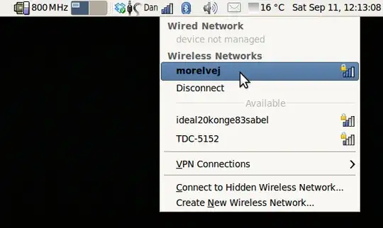

18
In the network drop-down selector of the system tray you can press the network you are already connected to. This will make NetworkManager ask for a new lease from a DHCP server.
NetworkManager tray screenshot
This also works for wired networks, but I don't think it works for PPP connections (mobile broadband).
