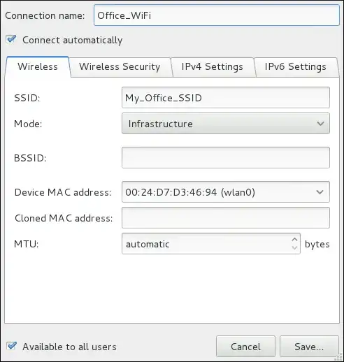

Generally, if you are using Network Manager, the /etc/network/interfaces file need only contain the loopback interface. Network Manager is supposed to handle all other details for us. I suggest you right-click the NM icon and select 'Edit Connections...' Select Wired and Wired Connection 1. Be sure that Connect Automatically is checked:
