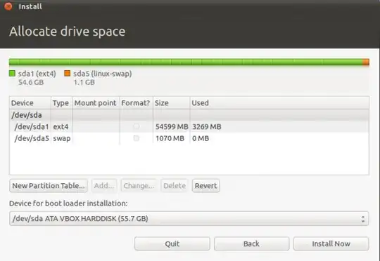

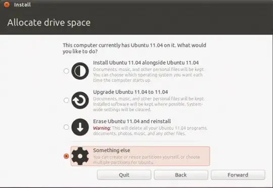

To reuse the ext4 and SWAP partition you need to specify them manually using the advance install (select the "something else" option).
(source: linuxbsdos.com)
Now you just need to unmark the ntfs partiton and mark down the partitions you will be formating for the install (you don't need to format the SWAP partition).
Please note that unless you have a separate home partition, formating will also delete the files you had on the ext4 partition. Consider moving your home to it's own partiton or create a separate home partition while installing Ubuntu.
