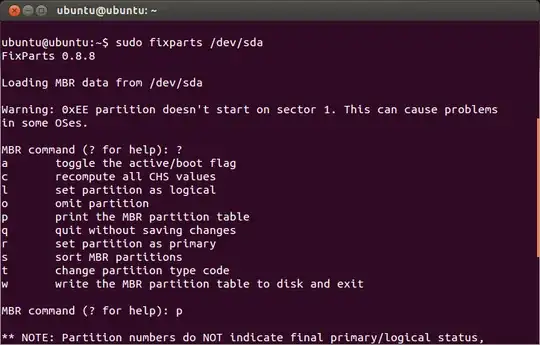

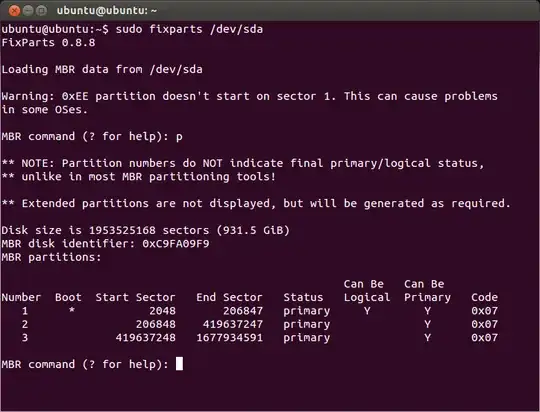

On the Ubuntu live CD, I downloaded and launched fix parts, there was no warning message at the start, i was following this guide(http://www.rodsbooks.com/fixparts/), so at first i thought it may not be any GPT data
Until I got this up enter image description here
According to the guide I should have had a warning at the beginning, and being given the option to remove it.

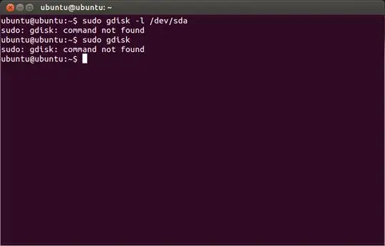

gdisk doesnt seem to be in the package i have? or atleast the command is unknown enter image description here

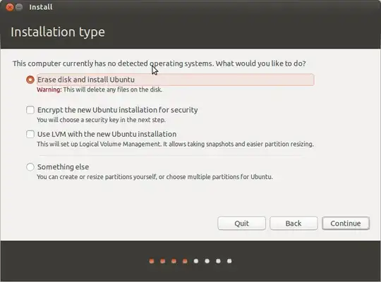

This is the problem i am getting at in the first place, i wish to install ubuntu (dual booted with windows 7) onto that unallocated space at the end of my drive
But the ubuntu installer (i read it uses parted) simply does not recognise the windows partition
Eventually i was aiming to use the Borg bootloader,i was expecting the option "Install alongside windows 7" and thats what im trying to get, so i googled this problem, and lots of people had leftover GPT data, so now i have no idea where to go
That's very odd; FixParts is presenting conflicting information -- the reference to a 0xEE partition indicates a GPT disk, which should cause FixParts to exit; but it's not exiting. Could you please post what FixParts shows when you type p at its menu, and also the output of sudo fdisk -l /dev/sda, sudo gdisk -l /dev/sda, and sudo parted /dev/sda print? (You can cut-and-paste this rather than post a screen shot, but please add four spaces to the start of each line to keep it properly formatted.) This information will help me figure out what's going on. (Incidentally, I'm the author of FixParts.)
