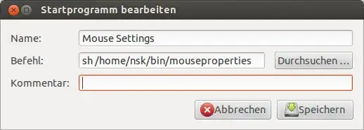

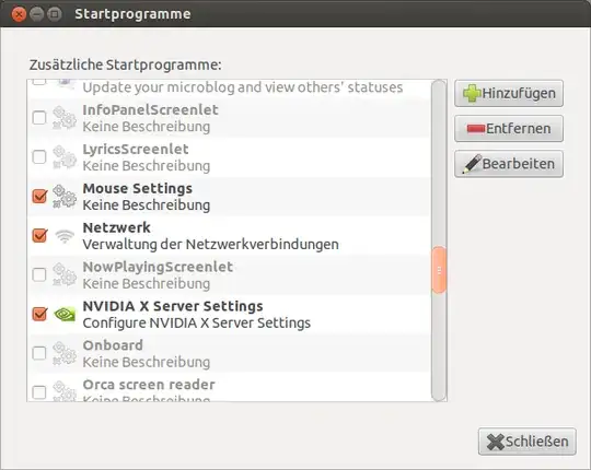

  7. Add a call of those xinput command lines in your startup programs: press Alt+F2 again, enter gnome-session-properties and press the execute button
  8. Press the button for adding a new program call
  9. In the following dialog choose a name and comment and enter the following in the command line:
    sh /home/<YOUR-LOGON-NAME>/bin/mouseproperties
  10. Press the add button
  11. You will see this "program" now listed with your name. This will be executed now at every login. Tune the value of "1" for "Device Accel Constant Deceleration" to fit your needs.
