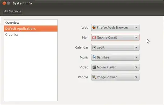

To set GMail as the default for mailto links in Ubuntu 11.10 :
  1. Install gnome-gmail
  2. Edit ~/.local/share/applications/mimeapps.list and add the line below:
    x-scheme-handler/mailto=gnome-gmail.desktop;
  3. Open System Info (use the Dash) and under Default Applications change Mail to Gnome Gmail
Screenshot of System Info

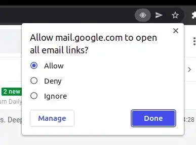

Open GMail on Chorme. On right side of search bar you'll see an 'eye' icon(highlighted on the image). Click on it.
Note - If you don't see the 'eye' icon. Go below of this answer to solve this issue.
You'll see this pop-up
Choose allow and click on Done.
That's it. Now GMail is your default email opener.

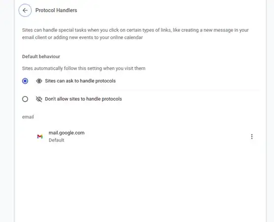

If you don't see the 'eye' icon on the search bar goto the Chrome Settings then search Protocol Handlers then somewhere you'll find this Protocol Handlers section(depending on version of Chrome) then select Sites can ask to handle protocols.
Now go back to start of this answer then follow the mentioned steps.
