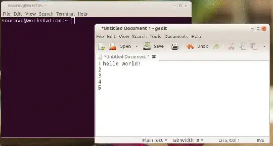

Say your selection is "hello world!". Next you run in terminal,
cngstr world potato
Use "" for a string consisting of more than one word. Next when you paste using the mouse middle clip, "hello potato!" will appear. See the screenshots.
Enter image description here
