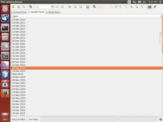

I've only seen this in Pan, it seems to do this on a quasi-regular basis:
The problem is how to "grab" the date column on the right hand side. Unfortunately, the little up/down arrow widget gets in the way.
How do I grab the column from the right hand side to resize the column horizontally, shrink it to make the other columns available?
(Yes, it's some sort of bug, probably with Pan, that it does this sometimes, but I'm just asking about how fiddle with the window.)
This:
https://askubuntu.com/a/45087/45156
doesn't seem to do the trick. I've tried resizing the window, of course.
Thufir
  • 4,631
There's something in preferences.xml which causes the header columns to be "infinitely" sized, I think. Renaming preferences.xml "fixes" the problem:
