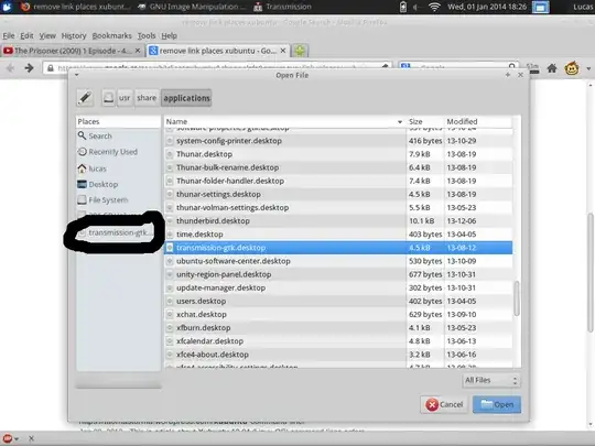

I accidently dragged a link into the pane on the left. When I right click to remove the link, it is grayed out and I cannot select it. How do I remove the link? (This is the ctrl+O menu, not normal window)
I think this is a bug. Update: I reported it: https://bugs.launchpad.net/ubuntu/+source/gtk+3.0/+bug/1265418
As a workaround, edit the bookmark config file and delete the offending line:
nano -w ~/.config/gtk-3.0/bookmarks
