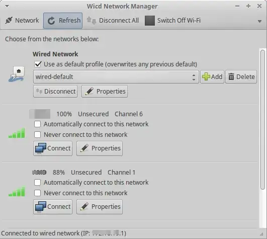

You can use WICD. if it not installed, then just press Ctrl+Alt+T on your keyboard to open Terminal. When it opens, run the command(s) below:
sudo apt-get install wicd-gtk
Once installed, run it to see connectivity, Access point connected to, properties, IP settings, and much more.
